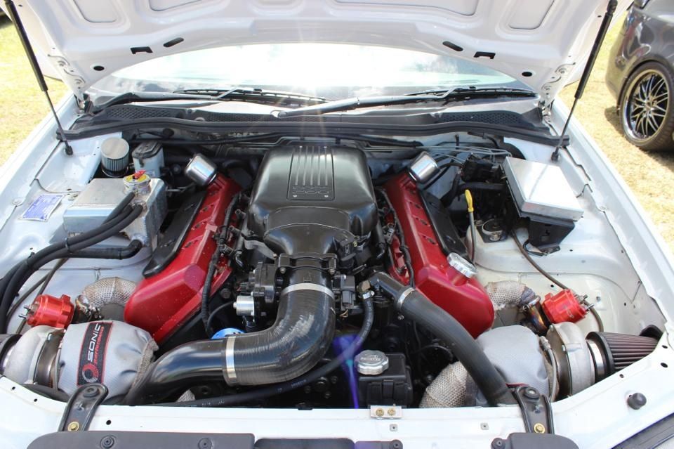

    People who say there's no room to turbo a boss aren't trying hard enough.

    Quote Originally Posted by defective View Post
    Nice, a blower in the valley may be easier but damn that looks impressive.
