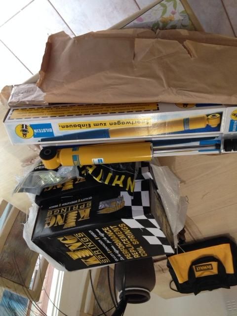

First up was a full service including gearbox and diff fluid replaced. A new high pressure power steering hose and a new steering rack were also fitted. Next was suspension, a set of Bilsteins, King Sl front and SSL rear springs, a camber kit and an aggressive allignment, the improvement over the standard 214,000km gear was obviously eye opening. Nice new lowered stance and front camber too.
http://i83.photobucket.com/albums/j2...CT/photo-1.jpg
The goodies arrive.
