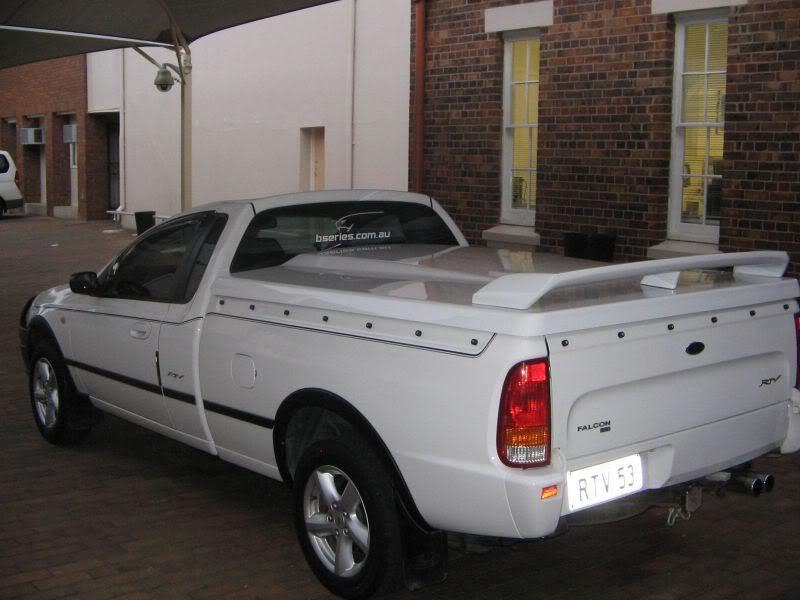

The Ute had a hard lid, a Black Leatherette job. It would have suited me, except the portable Fridge I had wouldn’t fit under the hard lid, so:
http://i195.photobucket.com/albums/z...HardLid_02.jpg

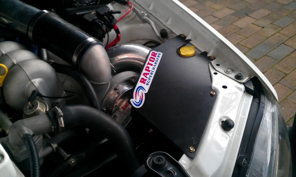

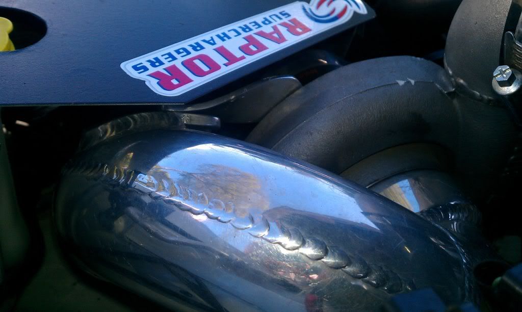

There was something missing….. more power. I had discovered a few things about RTV’s, namely, they came standard with the V8 Radiator, Transmission and the M86 Diff. So bolt on power wouldn’t tear the Ute to pieces, so research commenced and I found Raptor Superchargers, based in Mackay, QLD. Handy Units as they had ceramic bearings and the gear box was air cooled, so there was no drilling the sump and being concerned about oiling. Raptor claimed that 60% power & Torque were on the cards, which would be nice. The other handy thing was it was bolt on…..
http://i195.photobucket.com/albums/z...rAirBox_01.jpg
http://i195.photobucket.com/albums/z.../IMAG0154a.jpg
