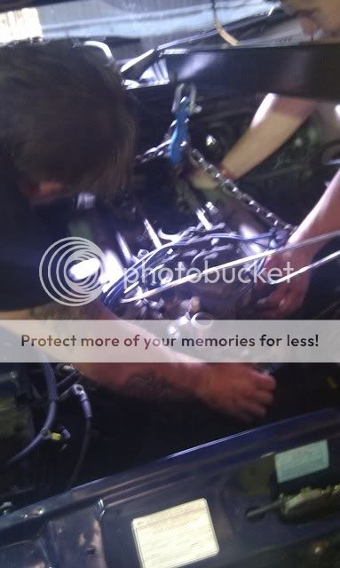

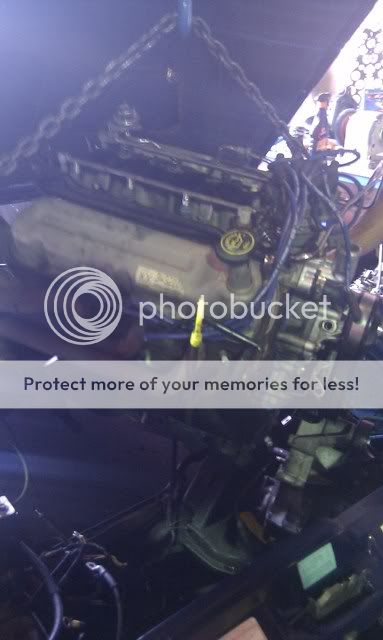

    Jeff and Matt removing everything so the motor could be removed.
    All ready to be lifted out.
    Here she comes.

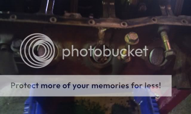

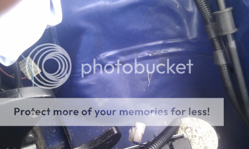

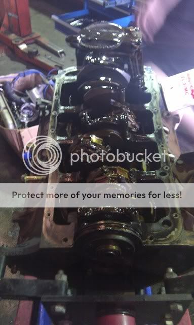

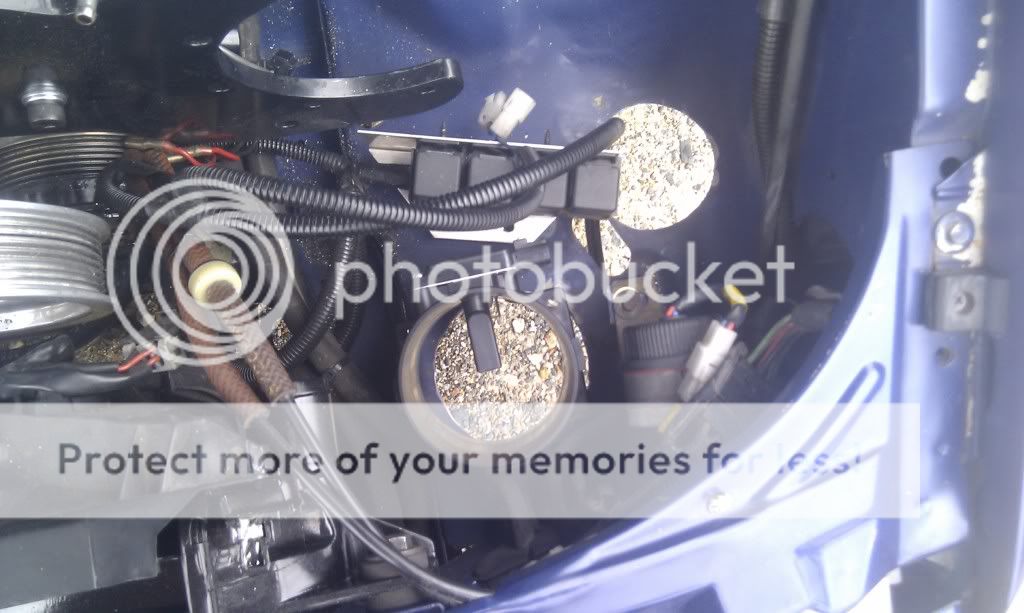

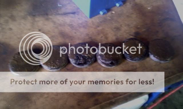

    I am glad I decided to pull the motor out and strip down. Matt was happy overall with the condition of the motor but we found this.
    Bottom end needed a good clean but was in perfect condition.

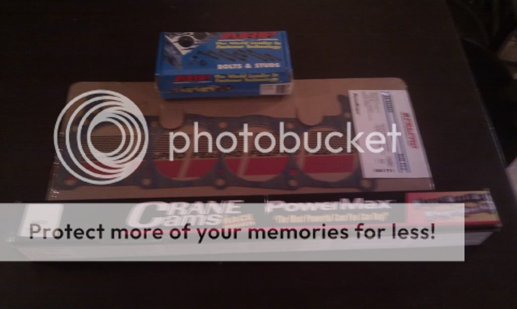

    While Matt at Streetbuilt started pulling down the motor, parts were arriving from Summit on a weekly basis. It was like Christmas for grown ups.

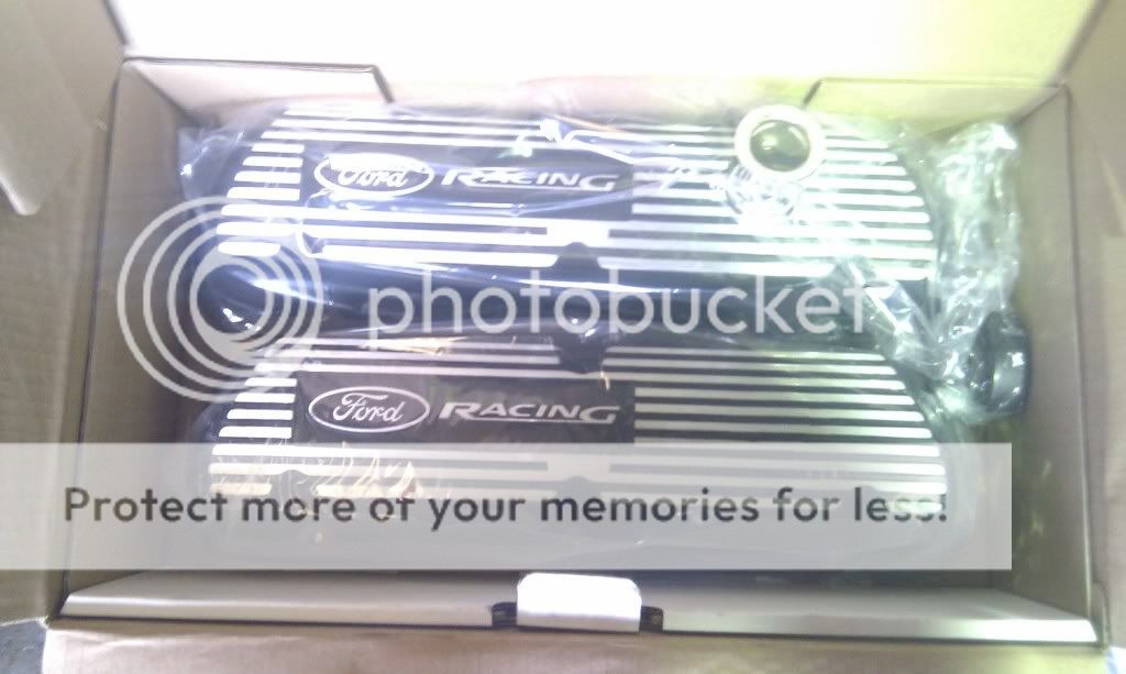

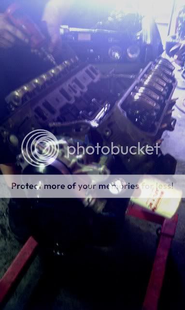

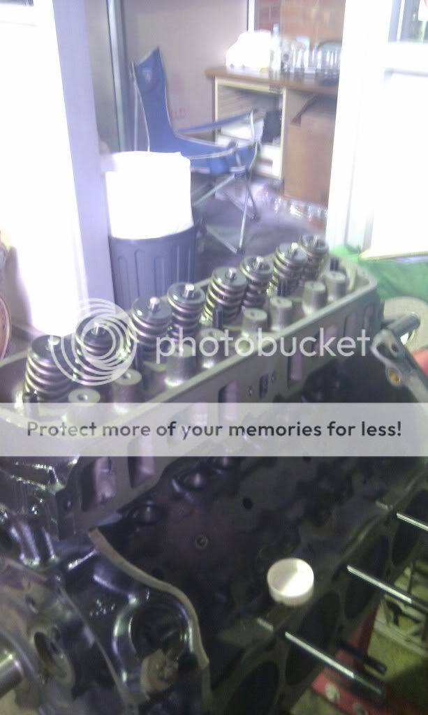

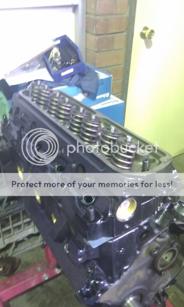

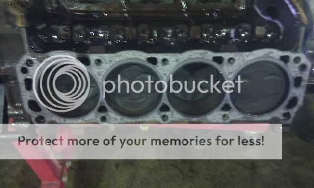

    We sent the heads off to get a clean up and new valves and springs fitted. Pic of the block without the heads, Matt was extremely happy with the condition of the bores.

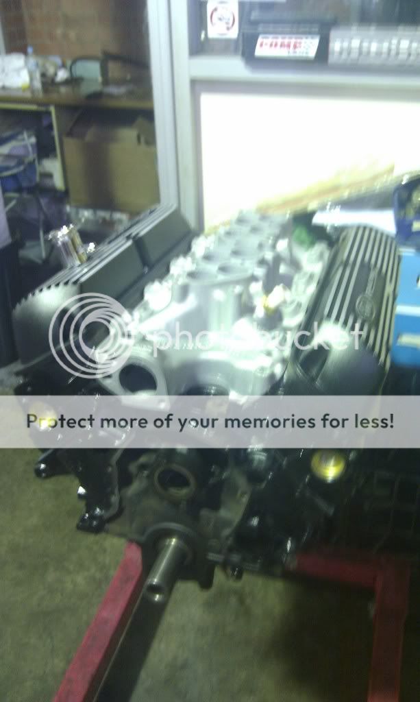

    When we got them back, Matt bolted them up and we test fitted the rocker covers. Looked Sweet as.

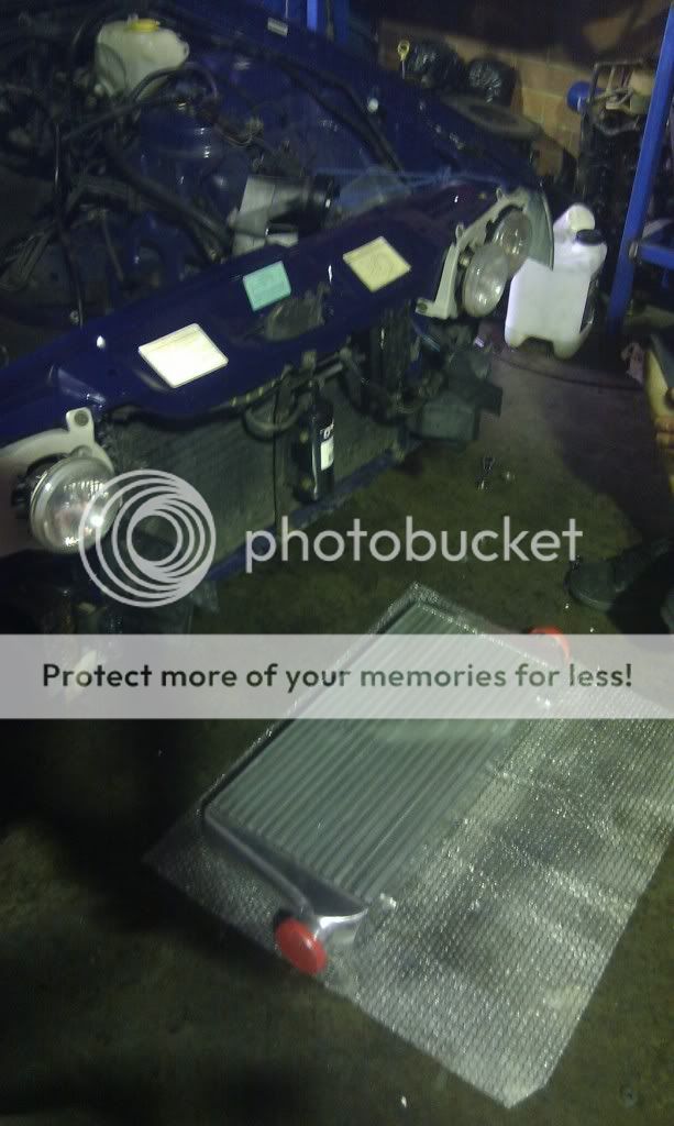

    Next piece of the puzzle while Matt was putting together the engine, was where to fit this.
    After much deliberation and test fitting it was decided that the air-con condenser had to be move to under the driver side guard to allow the intercooler to moved as back as possible.

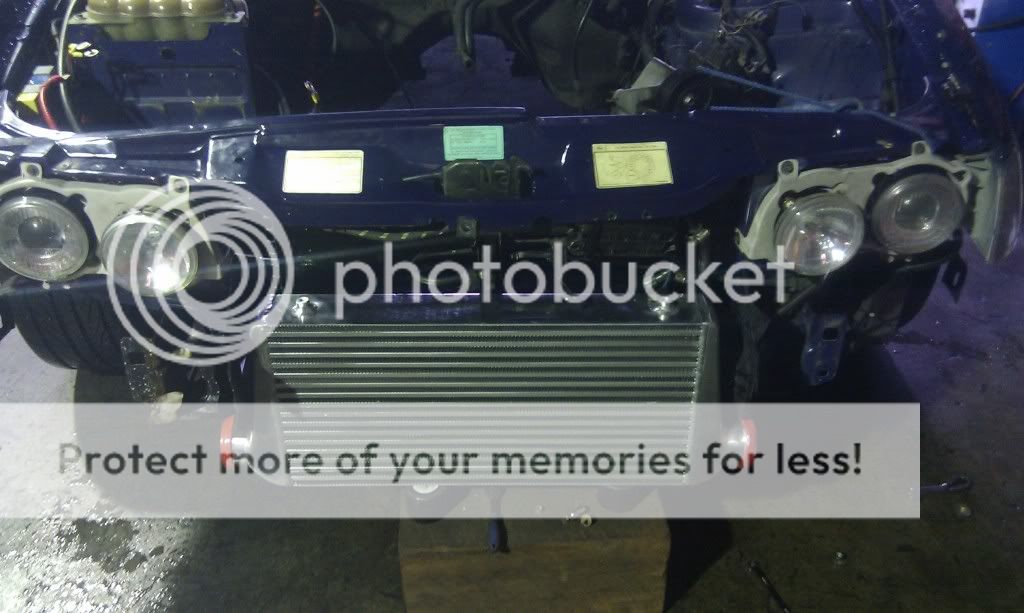

    Test fitting the intercooler
    We had to cut the crap out of the bottom of the front bumper for the cooler to fit. Once we were happy this is how it looked when we test fitted the bumper.
    Then Matt and Jeff made some brackets and the intercooler was bolted into place..

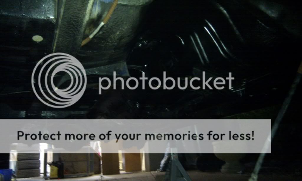

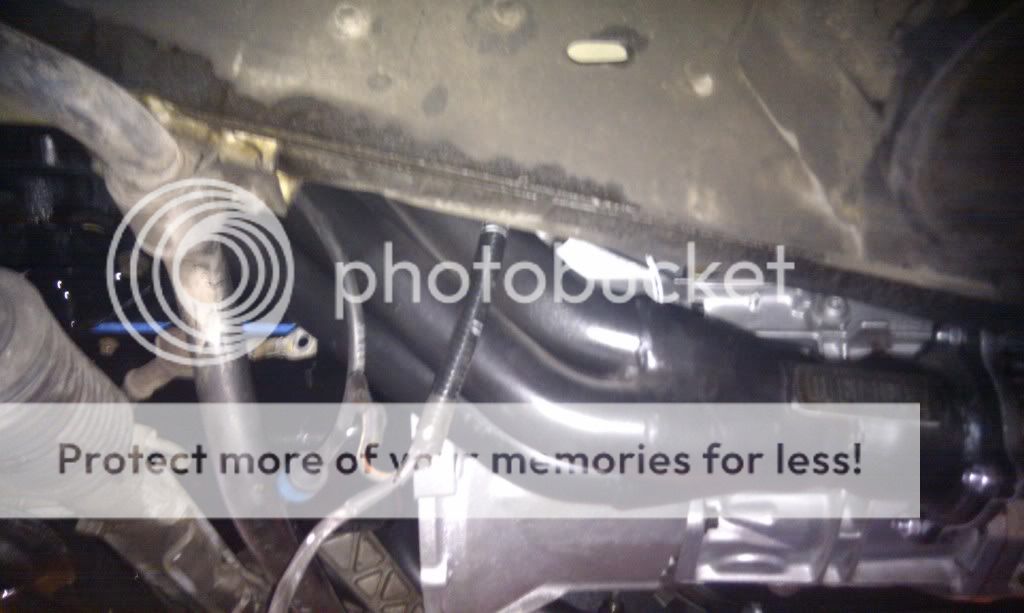

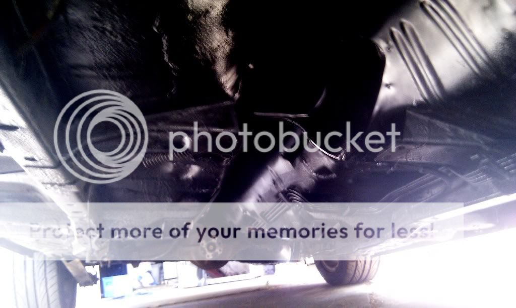

    While we were waiting for some other parts to arrive, I decided to take the Sprint home to give the under body a clean up. Decided to go with underbody black after giving it a good clean and degrease. I can advise, on jack stands - this is not for those who fear hard work or using some elbow grease lol
    All masked up to ensure I didn't get any over spray on the lower half of the panels.
    After giving it a clean but before the underbody black went on.
    After, made a huge difference.

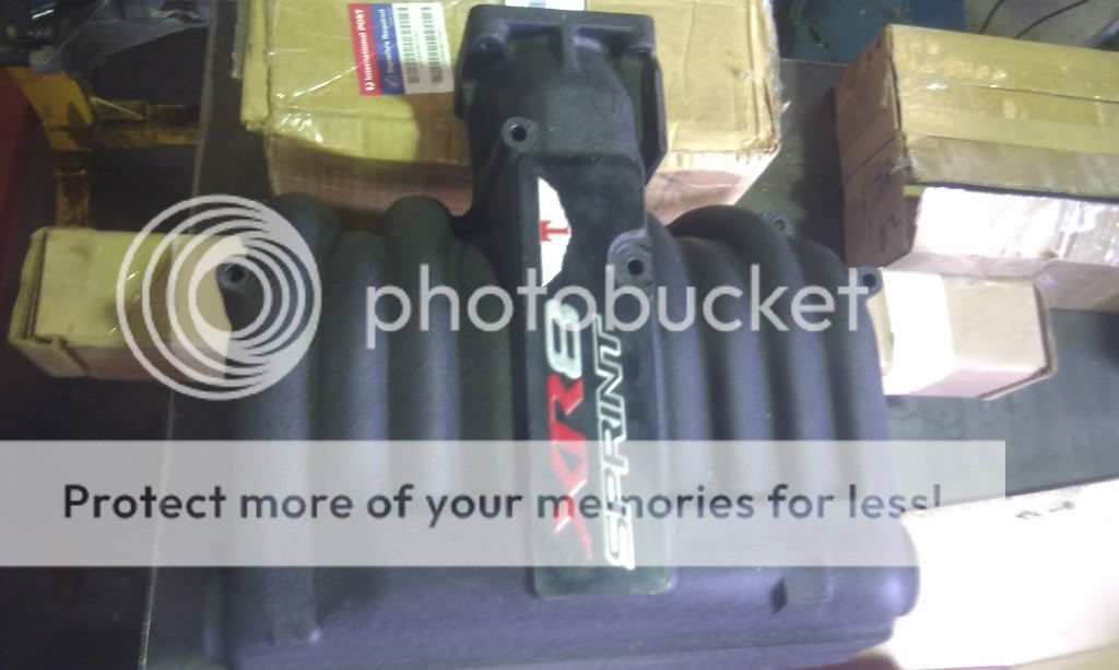

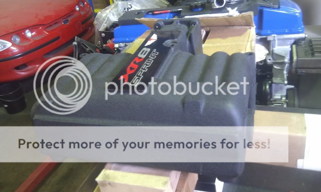

    I also decided after a bit of discussion with Matt and Jeff, while we were going with the whole 'black' theme we thought we might try something a bit different with the upper Sprint manifold.

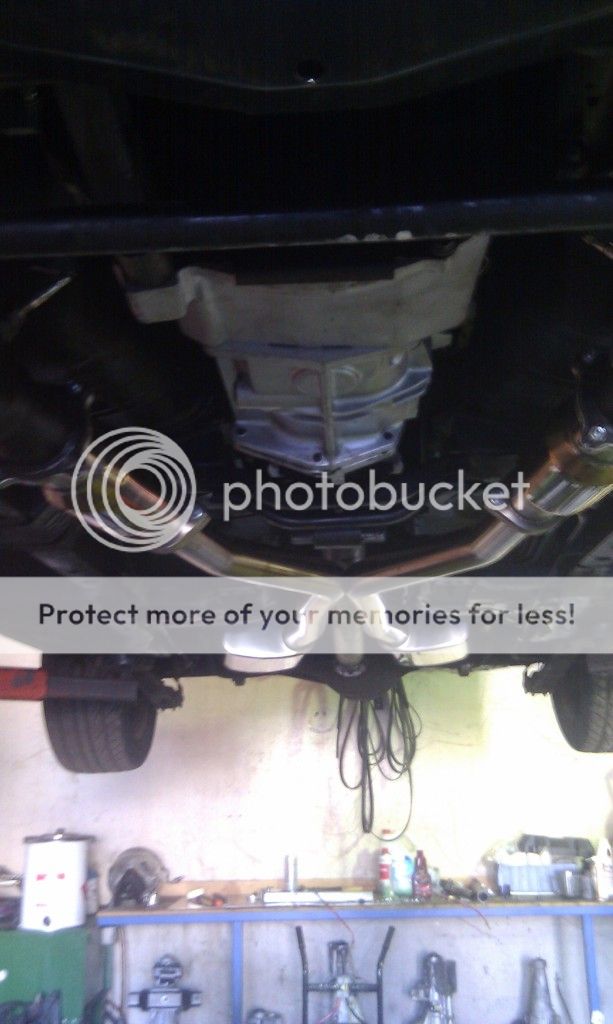

    To continue with the black theme and to go for a bit of stealth we painted the intercooler black. Its ended up being a bit of a pain now though as I have to keep touching it up but at least the cooler doesn't stick out like dogs balls.
    The Di Filippo 4 in 1 headers turned up, i didn't realise these come black as standard = win

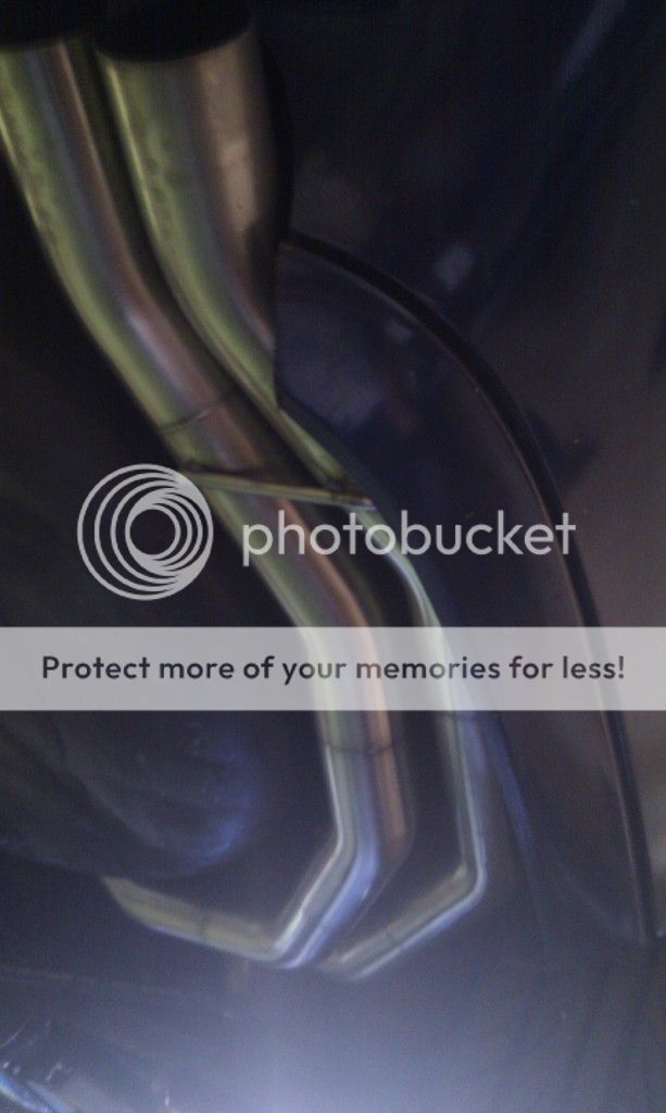

    Next was a trip of to Prestige Exhaust in Malaga - Ricky did an awesome job, talk about a legend. System ended up as a twin 2.5" all the way through with high flow cats and magnaflow mufflers.

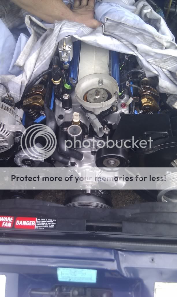

    Motor sitting back in the bay fiited up with the blower ready for all the pipe work to be fitted. I loved the black theme and still do.
